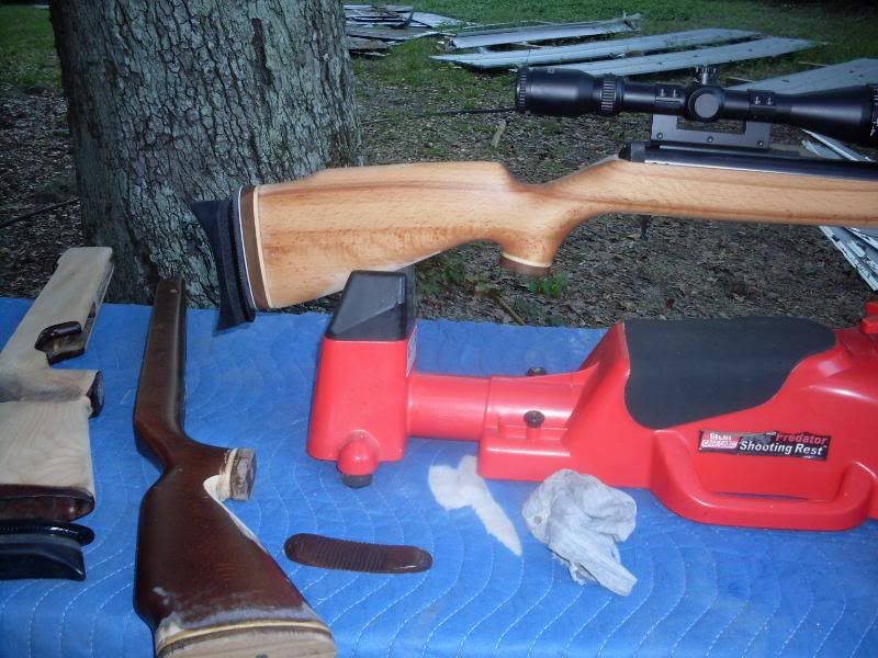

Got me ole "Butt" down off the roof & was so happy to get back on level ground I got Genes stock out & got to work on it again. I had already cut the front yesterday & epoxyed on the "White" maple spacers on so proceeded to drill the reinforcing dowels today & add the walnut extensions.Got em all epoxyed on & will be ready to carve/sand em tommorow after curing overnight. This one is "Shaping Up" to be my best ever. Looks kinda rough & "Cluby" in the pic but,,, the joints are among the best I have gotten yet. I really like the sanding shaping part. Some carefull inletting tommorow & the outside shaping is a "No Brainer"!!More pics tommorow. Tim.

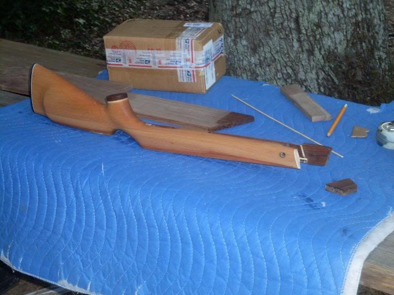

They look like big ole ugly "Blocks" of wood in this pic. All,s I see are two nice small pcs of walnut begging me to get ta shaping/sanding on!! The hard part is over now,,,,,now the easy FUN part begins!!The epoxy will be fully cured tommorow AM. Tim.

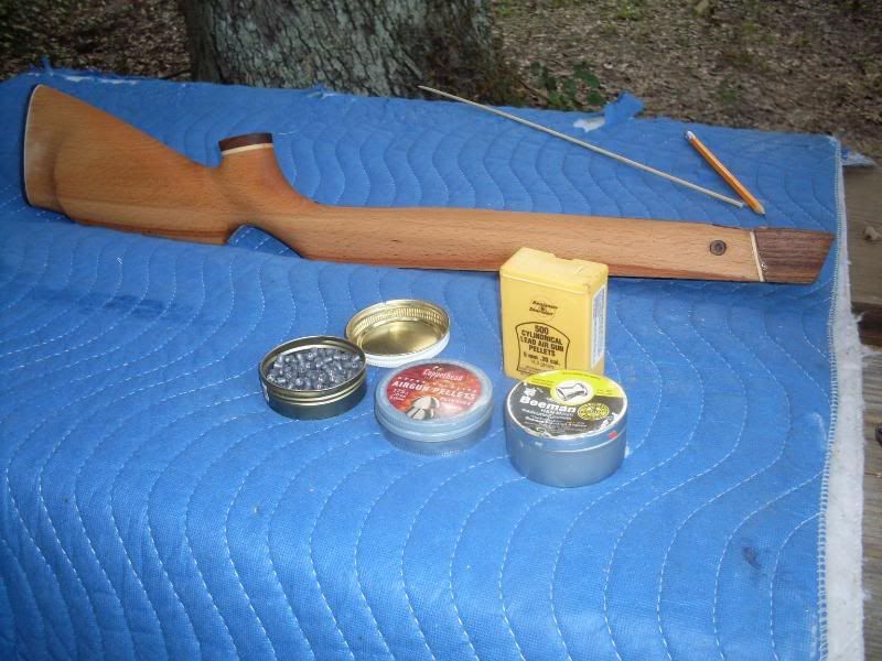

I got em shaped up & rough sanded today. I got the inletting all done for the tube & clearance of the breach block screw. The ends extend beond the tube so it is inletted to hide the end of the tube.All the "Construction" hard part is done now,,,just some final hand shaping/sanding & she will be ready for a slick finish!! Not sure of what route Im gonna take on the finish "color" yet,,, Gene said he did not want it "Blonde"?? Ok,, I will not go "Blonde",,,,, but it is gonna be a VERY light stain!! Either way,,, she is gonna get a hand rubbed oil finish like J did on Mr Bob,s FWB124!!Timbo.

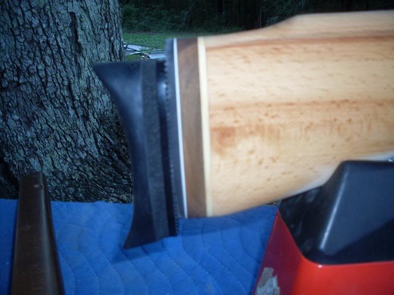

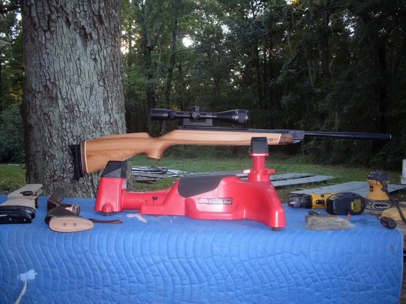

I also extended the butt today to match the grip ext & forearm extensions!!The beutey of this add on is: The walnut & white wood spacer are epoxyed together. They are NOT epoxyed to the stock. 2 screws inside under the butt plate white spacers hold it on. This means,, the walnut/white wood spacer can be removed & Gene can use only the adjustable Morgan butt pad & white plastick spacer if he finds the l.o.p. too long!!If you look at the pic close you can see I shaped it so everything would match up either way!! Man I LOVE doing this!!!!! Timbo.
