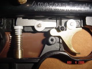

  I "grew up" shooting airguns and firearms. In my early 20's I got into Jeeps and motorcycles and got away from guns / hunting. Several weeks back I bought my son an airsoft gun and we spent some time shooting it in the back yard. This prompted me to dig out my old cummins tool chinese air rifle. I tried for a few days to get some kind of pattern out of that thing with no luck, but my interest in airguns was sparked. I looked online and couldn't believe the wealth of info I found on airguns. Wanting to get more into the sport, but not particularly liking my chinese rifle, and not having much $ to spend I ordered a refurb 1377c from pyramydair. It's much more accurate than the china gun or maybe it's just I'm more accurate with the 1377. I've had it for a couple of weeks now and I'm completely hooked! My wife thinks I've lost my mind, but I'm having a blast. So far I have deburred and polished the sear, made a sear spring guide / trigger stop, lighter sear spring, and delrin spacers for the sear and trigger. Here's a pic.

Thanks! Got that pic in there now.

You have made a fine start, and I really like what your doing to that fine 1377 !

Looking good Matt!! I like what you did on that 1377 trigger. keep up the good work and welcome to the GTA.

A big welcome to the GTA forum and family.  Wow.....you're good with tools!!!!  You're new here.....but I'm sure alot of folks here can learn from you.  Great job on the 1377's trigger assembly.  Her firing is going to be smooth as silk.
