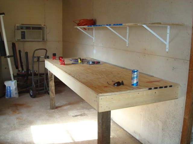

Built the work bench today. It's 38.5" high and 3ft deep with a 1ft by 8ft shelf above it. I know It's sturdy cause I had to climb on it to instal the top shelf! Framed with 2x6 lumber with a 3/4" top and treated 4x4 legs in case I get water on the floor over the years.

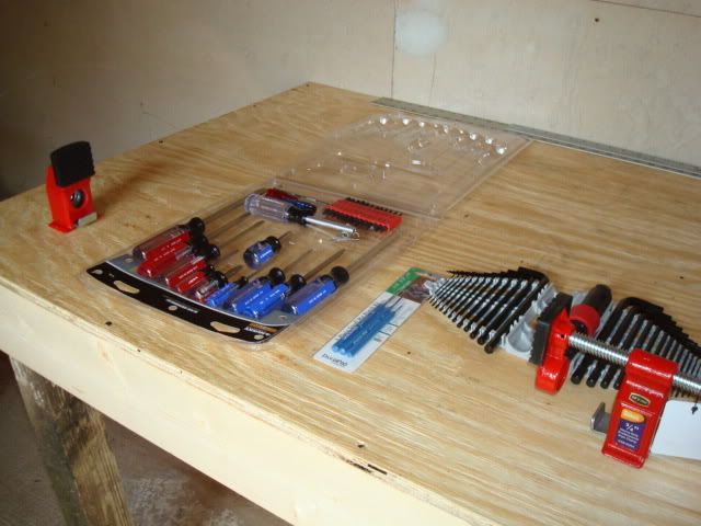

3ft is no problem for me to reach the back wall. I also picked up some punches and some Allen wrenches today as well as some more screw drivers.
Here she is;
Not ready to start just yet. I gotta get lubes and some tools for polishing and..........................................

If you are going to use those bar clamp parts for a spring compressor make sure you make something to hold the action to the bar so it does not try to rise up out of the clamp when you compree the spring. Nice Bench. I always build my own too.
Re: Getting started
« Reply #19 on: January 23, 2009, 10:49:26 AM »
Well I got the bar clamps and I'm still not sure they will work right. So they may take a back seat. I want to make sure I have no problems removing and replacing the spring without having to have three hands.
Any suggestions??
Send pics.

The refrigerator is IMPORTANT.  I keep "pain reliever" in mine.  You may want some band-aids and neosporin too!
Also, will that fence stop a 7.9 gr. pellet traveling at 700-1000 fps?  LOL!  You may find out one day!!
That work bench seems long enough to be able to shoot on.  I put my rest in line with my chronograph and a cardboard box full of rags as a pellet trap (test it outside first).  I am able to fire pellets well into the wee hours of the night.  You need lights on the chronograph to shoot indoors.
I also used the plans that Charlie has in the library for the spring compressor.  Those plans are somewhat difficult to understand when it comes to the holes and whatnot that hold the action in place.  I sort of took my B3 apart and built my spring compressor all at the same time, so it would all make sense.  I am building my second spring compressor several inches longer than that one and I am putting holes in the base so that I can firmly attach it to the workbench so that it doesn't bow under the pressure of the springs.  Two holes in the middle, as the ends don't bow up.
Looking good so far!

You need to wire that work bench with at least 4 two outlet grounded 110V power outlets now, before it gets covered up.  And you need to hang two bright fluorescent light fixtures overhead.  But the Fridge is a good idea.
RE: Getting started(update step 2)
« Reply #23 on: January 23, 2009, 01:44:15 PM »
Good call on the plugs T man! I've already tripped over cords once too many times today.

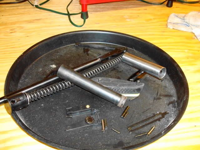

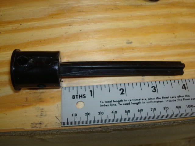

Well I took the advice here when using a bar clamp for a spring compressor and added a large C clamp and some wood to hold the action in place. BRAVO! No problems getting the spring out at all.

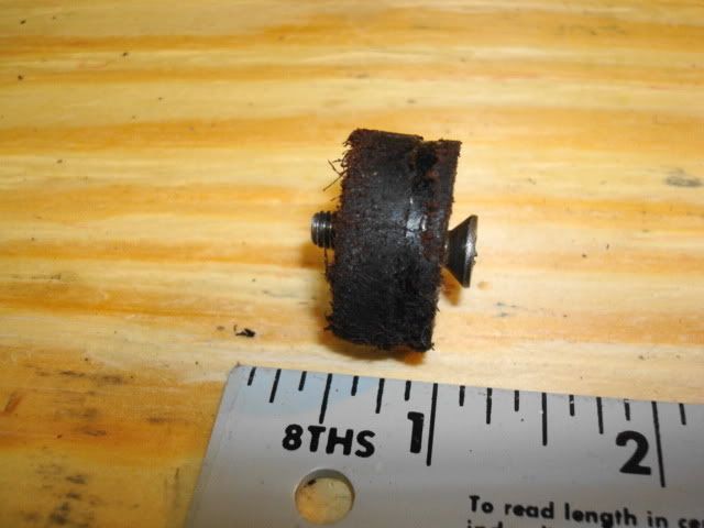

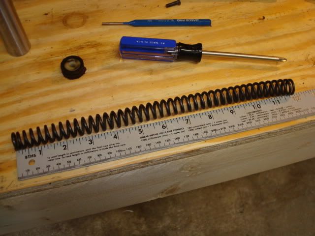

Got all the parts cleaned up real good and finished polishing the cylinder and de-burring it. The spring guide is plastic?? The spring has a slight bow to it?? The piston seal is leather. And it sure seams like I got more parts laying out than I took apart??
I think I have done all I can do with the tools that I have now unless there are some other suggestions. I can't make a spring guide or shims/spacers yet. I read where it is advized to polish the ends of the spring so I did, but also to polish where it rests on the guide and in the piston. Can't reach where it rests in the piston????
