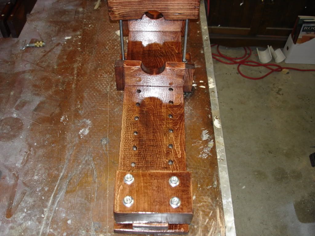

The new spring is unset,meaning it has not been compressed yet once the new spring has been fully compressed it will be the same or even a little shorter than stock. I have had problems installing new springs even with a compressor. So before you attempt it again do your self a favor build a compressor . BE SAFE
Look in the library for plans or do a search. Or here is a pick of my latest one.
