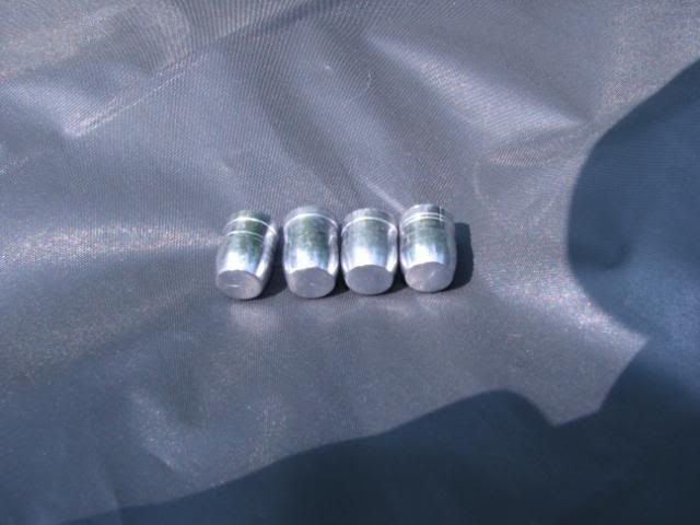

The Lyman Devastator
http://i181.photobucket.com/albums/x65/butcher45/DSCN5667.jpg

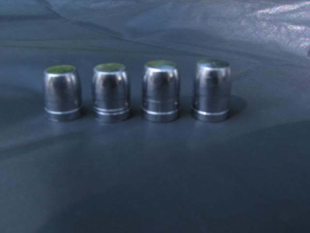

These slugs (cast by BlackHogDown) are likely the future of bigbore airgun hunting projectiles.
http://i181.photobucket.com/albums/x65/butcher45/BHDSlugs.jpg
http://i181.photobucket.com/albums/x65/butcher45/BHDSlugs2.jpg
