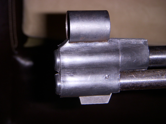

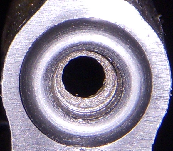

Been shooting my B3-3 lately and even after a nice tune and a solid scope it wasn't shooting very well so I took a look at the muzzle crown and was saddened to see what I think is a chip in the crown.
was wondering if anyone else has had similar problems with their B3s and what sort of improvement they got after recrowning.
Also as this is the newer B3-3 rather than the B3-1 it has a plastic catch on the front which holds the cocking lever up.
Has anyone removed one of these before? it doesn't seem to be pinned on but rather glued?
If anyone has any suggestions for getting it off I would be much obliged.
Kimball

The sight acts like a very short muzzle break and I can't get any tools in to refinish the crown.  Tried heating the barrel to loosen the sight, but no success so far.  Any suggestions as to how to remove it? would like to keep it intact if possible as it does seem to function well.

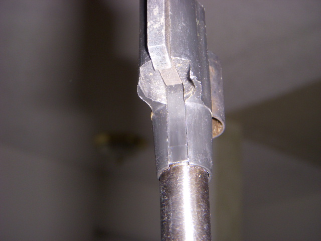

Was able to get the front sight off! just took enough heat to soften the plastic enough to let go.  Apparently it looks like it is not glued, but just held on by friction.  A little goo gone helped lubricate and release it too.  There appears to be 4 crimps in the metal which serve to orient the sight and keep it from shifting.
Going to file it down and redo the crown and then post the results.

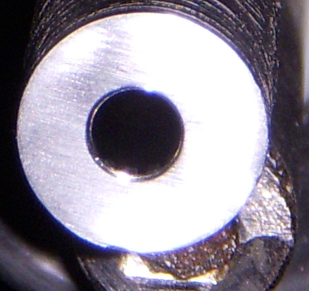

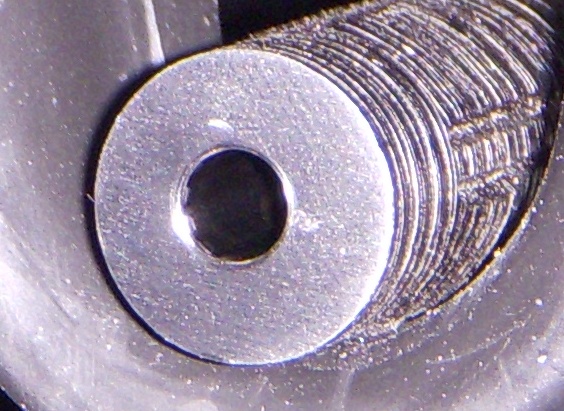

« Reply #10 on: June 14, 2009, 07:27:42 PM »
Heres the finished crown
Going to bed now. Gonna let you know how it shoots tommorow -_-

That's outstanding crown job..let us know how she shoot from her polished hole!

Just a matter keeping after it until it gave in. :) The new crown look's good 8) keep us posted on it's grouping. Ed
