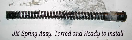

Hello everyone, I posted a few weeks ago my troubles with a broken spring of the Quest. I ordered the JM E3650 spring and a small Apex (red) seal. I de-burred every part that was rough, including the top hat, rear guide, reviever, etc. Once I got the seal in, which btw took a lot of effort because the seal is a tag larger than the stock seal. Anyhow, I tarred the spring and before I push it all the way back in, I wanted to make sure that the spring is the correct length. Below are pictures for you to look at and as you can see there are about 6 coils sticking out. Is this okay? Or is the spring suppose to be a little shorte?. I do know that these springs have preload but I just want to make sure that if this is the correct length. Thank you to ALL (mikeinowa, tjk, Gene_SC, and everyone else whom I have not mentioned) who helped me with their guidance to get this project finished :)
Here are two pics with and without flash :)

If you didn't order your spring "set" it is going to be a little longer than the original. Once you cock it will "set" to the proper working length. I would remove about half the lube you have on your guide. Too much lube slows the action. If you used moly "less is more".

I agree..too much grease is bad and it will find it's way to the front of the seal.

Thanks you both. Yes what I have is Moly on the guide. I guess that needs to be removed a bit according to you. This is my first ever "tuning" project, so I didnt really know how much is too much :P What about the tarring of the spring? Is that good enough or needs more or less as well

Wipe every other coil. Just remove a little from each and you should be fine. It will spread around when fired.

It also appears to me that the rear spring guide is a bit small. There should be NO daylight between spring and guide. Same goes for the top-hat, you want a interference fit on both. Another thing to look at is the fit of the top-hat inside the piston. The one's I have found have a poor fit, major OD being undersize. Setting the spring with sloppy guide fit is a poor practice and could ruin the spring.
