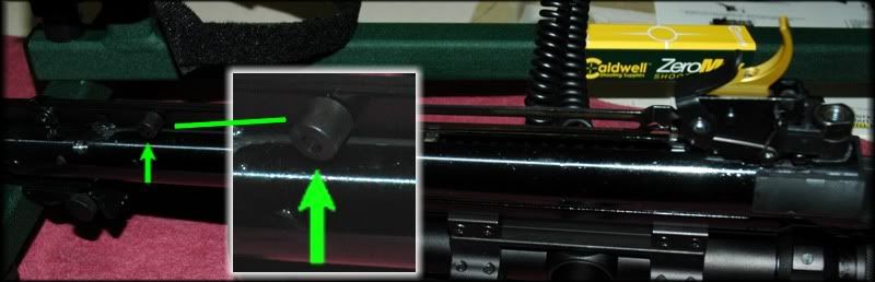

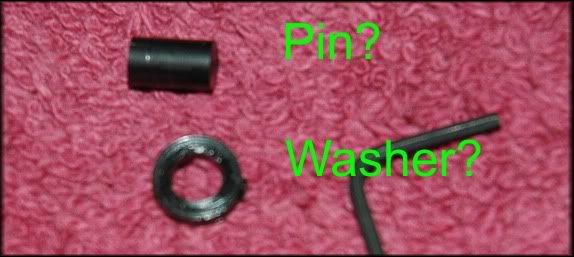

I just completed my GRT-III mod and when I was done assembling the gun I found a couple plastic parts that I have no idea where they came from. Any ideas? I tested the gun and it seems to work great... smooth as silk trigger.
So what to do with these parts? the pin fits perfectly into the cylinder.

Hi Jim,
The cylinder is a roller that goes on the cocking arm -- falls off when you remove the stock -- part # 14300 on this diagram:

Thanks for the schematic. I think I see where it goes - Is it on right? Does it matter?
When I took the stock off again I also found a plastic washer about the same diameter as the cylinder. It was stuck in the grease near the spring. Must have fallen off as well? So now I'm still wondering where the pin and this washer go?

Check out the "BC Washer" thread at the Gamo Gate;
http://www.gatewaytoairguns.com/airguns/forums/thread-view.asp?tid=24278&mid=192254#M192254    The plastic washer goes between the black plastic cylinder roller and the cocking arm/linkage.
The pin I have no idea where that goes......never saw anything like that when I opened up my Gamos.

Thanks gamo2hammerli
I did try putting the washer on first, then the cylinder. It didn't seem like there was enough pin there to hold both...but I believe you... now what about this other pin? could in now be inserted into the other end of the cylinder? I tried that but that's really sketchy.

READ THE INSTRUCTIONS
If the installation instructions were read in their entirety before beginning the installation as instructed at the top of the instruction page, a person would see that all of that information is mentioned are in the installation guide. Also, I did not see the old adjustment screw in the pics. The instructions also show what parts are left over including the little pin.
