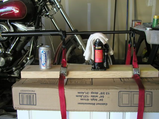

You need a Bikerscum Barrel Straightener (BSBS)...
http://img.photobucket.com/albums/v309/Bikerscum/bsbs.jpg
 20 bux, will fix your problem.
 BS

« Reply #4 on: July 03, 2006, 01:11:07 PM »
Hmm… I’m not sure if it’s a right lever point for bending. Wouldn’t it be right to move it closer to the breach?

« Reply #5 on: July 03, 2006, 01:15:15 PM »
Actually, that would bow the barrel. You want to bend the entire barrel from a single point to keep it straight. Right at the receiver block is usually best.

Ok, so..... move the jack closer to the breech?
BSBS MK-II

« Reply #7 on: July 03, 2006, 03:01:49 PM »
yes, but you only need one restraint point on the barrel. The other should be on the receiver block or you'll still get a bow in the barrel. What you might want to do is restrain the block, slide a heavy pipe over the barrel and put the jack at the end of the barrel. Lots more leverage that way. Thats how I do it. Tweak it just a little at a time, and the barrel stays straight.

« Reply #8 on: July 03, 2006, 03:12:57 PM »
I think it's more correct placement.

« Reply #9 on: July 03, 2006, 04:14:42 PM »
The barrel in the pic was my Fast Deer barrel. It was bowed, in a more or less constant arc from end to end. I just assumed all droop problems were that way.... my mistake.
Thanks for all the tips.
