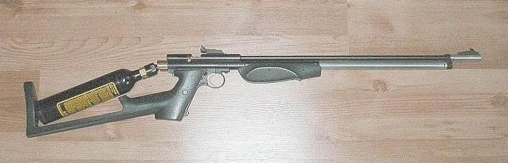

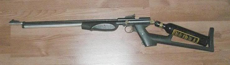

He ain't pretty but I got the balance just perfect :D (for me anyway :wink: ) .22 cal 24" barrel 2289 tube valve taped into the side Crosman steel breech Thompson sights
http://img.photobucket.com/albums/0603/GAEWEN/Airguns%202/LongJohn001.jpg http://img.photobucket.com/albums/0603/GAEWEN/Airguns%202/LongJohn002.jpg
http://img.photobucket.com/albums/0603/GAEWEN/Airguns%202/LongJohn005.jpg

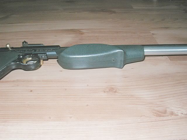

The 3/4" aluminium shaft is turned down to 5/8" for 4" so that it fits into the tube. One hole, drilled and threaded, provides a mount for the fore stock.
http://img.photobucket.com/albums/0603/GAEWEN/Airguns%202/LongJohn003.jpg

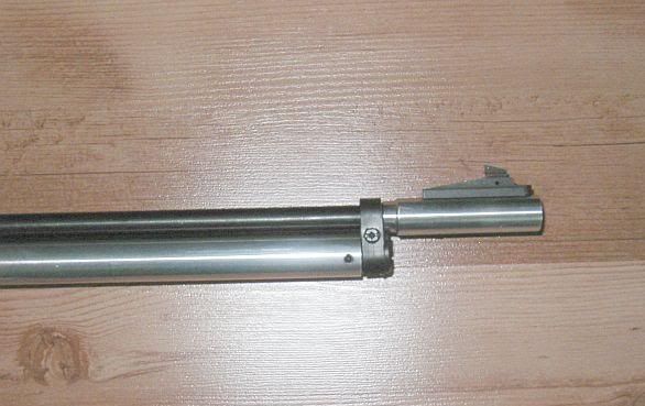

The other end is drilled to fit the barrel band.
http://img.photobucket.com/albums/0603/GAEWEN/Airguns%202/LongJohn004.jpg

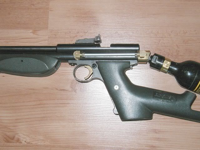

Here is a better pic of the plumbing,,,,,,,,,,,,,

The aluminium under the barrel is a solid shaft that serves two purposes, It gives enough weight up front to balance the gun nicely. For those who have handled a muzzle loading powder burner you will understand when I say that this gun has the same "feel". It also stiffens the barrel and should give it some protection for the rough use that this gun is likely to get as it is going to be my bush gun.
Best of luck with your 1322 project. I look forward to seeing the finished product.
