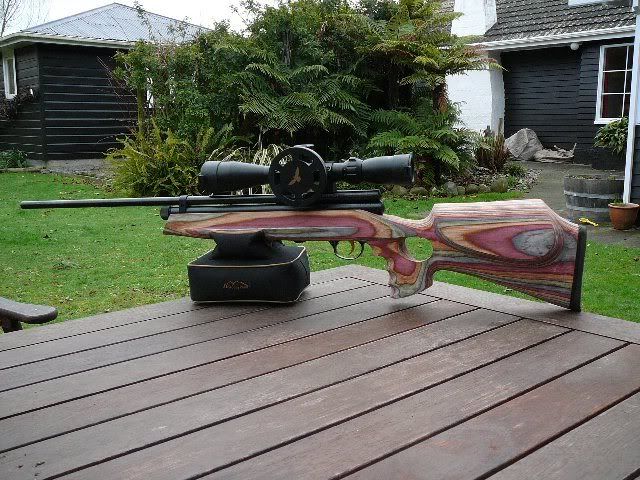

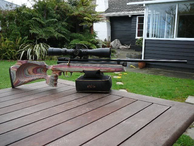

Did say I'd not fool with the insides once I got to 600fps...and I haven't....but I've been fooling with the outside.  Cut  4 1/2" from the barrel, recrowned, remounted the brake, and got a surprise.
Might be becasue the only internal work has been to the transfer port, could be the rifle breaking in and smoothing out, but chronographing the 17" barrel showed a slight gain over the issue 21 1/2" barrel.  Nothing major...like an average of 8fps...but still a surprise.
Rifle isn't short....but it's a bit more proportional to the stumpy stock.  Swaped scopes, putting the short one on the short rifle, and resighed in...accuracy isn't harmed, so the recrown is OK. Next step is to strip the finish and see if I can get it to match the QB 78.
Robert

Not quite...shoots just as well (it had a good crown from the factory), so accuracy wasn't harmed...but was surprised that it shot a little faster.
Robert

Pretty girl's there. 8) Ed

Got the stock done, refitted the recoil pad, converted to a 90 degree safety, inletted the stock so the safety can pass on take down, tuned/polished the trigger.
Robert

Looking real sharp, still sanding off the old finish on my 79 a couple hours each day on it.  That finish penetrated real deep in some areas and I'm getting a little nervous about going to thin.
 http://archerairguns.com/airguns.html  has a Carbine 7" shorter barrel (3" overall after brake added) .  His experience is it looses roughly 10% with a 14" so my guess is you found a sweet spot at 4" shorter with stock valving.   I have a Carbine from him in both .177 & .22 and they do shoot lower FPS than my reg barrel length 78d .177 and AR78 .22 by a bit more than 10%.
I had the brake off the .177 and it looks like it was shortened from the front of a stock barrel as the crown behind the brake is near a straight 90' with a tiny chamfer if any to speak of.  Still is repeatable though I like to shoot it offhand as I have thumbhole stocks on the carbines.
Cheers
Mark
Sure hope Mike M's stuff is going well for him as the 79 he did for me is just awesome and Gene's (AirGunToys) castled end shroud is sweet on it too.
