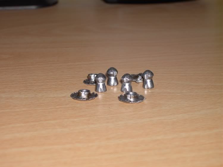

« Reply #4 on: October 22, 2007, 02:19:25 PM »
Would the marks happen to look similar to these???:
http://i210.photobucket.com/albums/bb9/StevieLaner7777/PICT1111.jpg
If so you've got the same problem as I had awhile back!!
Stevie

« Reply #5 on: October 22, 2007, 05:56:44 PM »
no it was like the pellet was folded into itself before it left the barrel and rotated through. it was probably just the walnut doing everything but it was just weird. my dad lost the pellet and he was the one who was worried. i havent had any problems since as far as i know.
