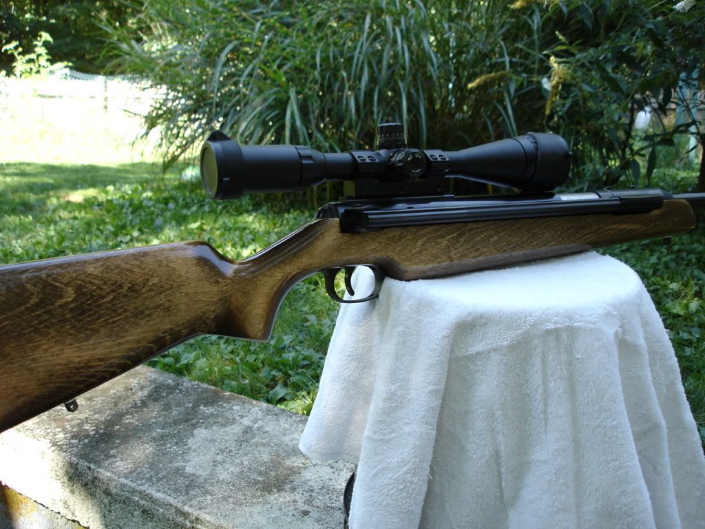

Messing with some different idea's with bare stock's, bringing out the grain then thinking about splashing a light stain over it. It would be finished with a clear but still got the other side to grain up so to speak along with the bottom. This is just something that I'm trying out, don't know where it's headed lol but will keep after it. I had a spare stock laying around to experiment with and it will hold a Gamo action in the end, will keep you updated if I'm liking where it's headed hehe. Ed

Thank you brothers it let's me know that I'm headed in the right direction I think lol. Yup Timmy you gotta get something to me to do bro hehe, Sam I'm air brushing over the original grain lines with dark brown. I'm thinking that when I put the stain to it the other spec's of grain here and there will then stand out and give the stock more depth and a real wood effect.:) Ed

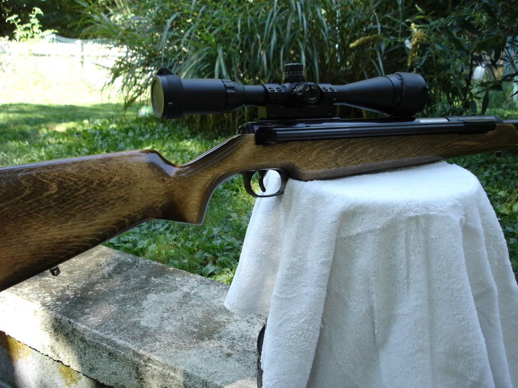

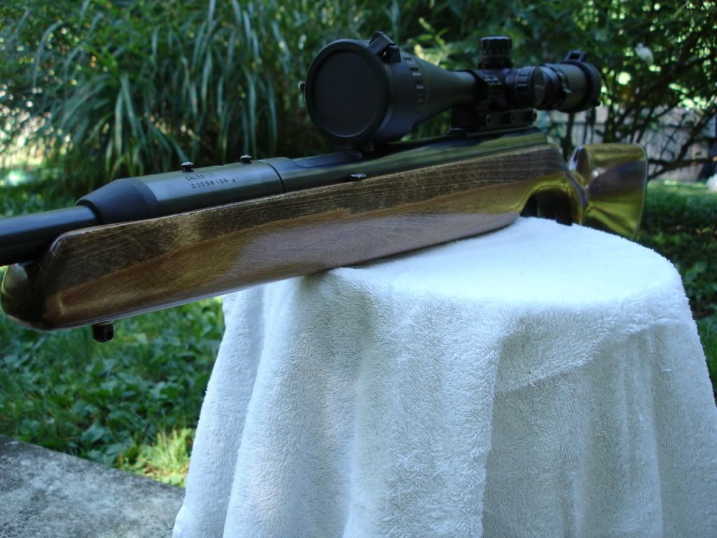

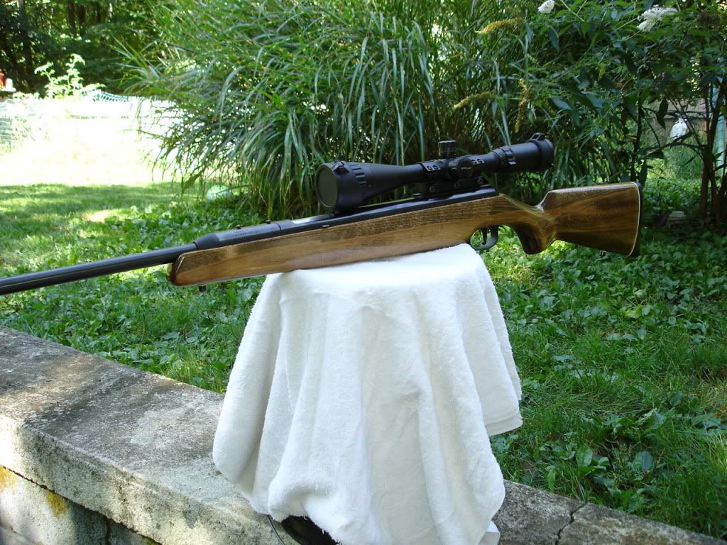

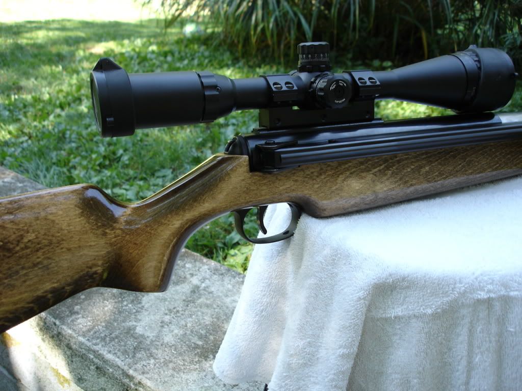

I finished up with defining the grain in the wood then applied one coat of Antique Walnut stain and that's just enough to give it the look that I was looking for.:) For the stock's that have grain that just doesn't stand out or wood stock's with lack of nice grain, just define the grain or add some and presto hehe. I'm happy with one coat so I will let the stain cure then work on sealing the stock. This was just a idea that I had been mulling over and what better stock to try it on the my own hehe. Ed
