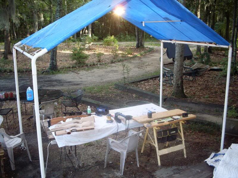

Yup Scott,,, I will be useing my trusty belt sander as well!! Ya really need a state of the art shop like mine!! LOL!! Honestly,,,, the work table in this pic doues a wonderfull job of holding stocks while Ya blast away at em!!Tim.
