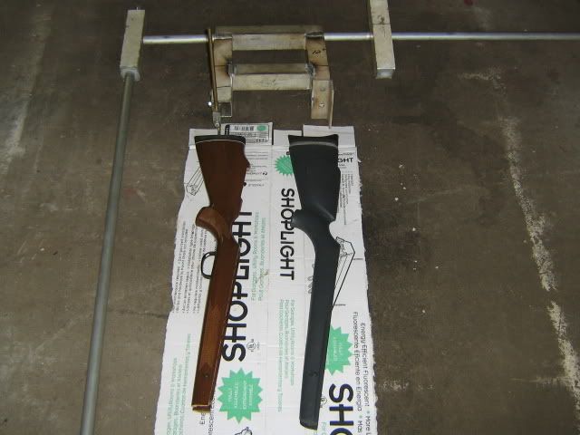

seems like forever ive been working on this for Mike..in reality actual time was about 6 hours...anyway heres mikes new toy..its not pretty yet (needs paint job still) but all the grunt work is done.i'm not sure of the exact width or lenght..i'll leave that up to mike.

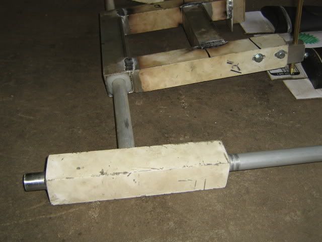

its made from square alum tubing with pressed in teflon slides right/left back/forth.

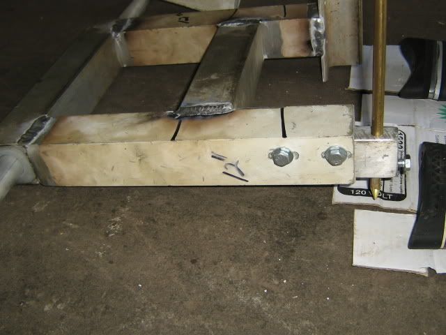

i did a little change to the tracer rod.it's adjustable up/down and in/out...for those cuts when you need to make slight adjustments..i think that will help the final outcome.
and just another view..you can see the semi square cut teflon slides...and man is it a dream to move.
if you see something i have over looked please let me know now..before i send it home.:)

Looks like it will work just fine, Paul. Now all I gotta do is learn how to use it,hehe. Should be able to cut the time it takes to make a stock way down.
Thanks again,Mike

Whats going to be doing the cutting??? A  Ball Mill in a router or something similar?

« Reply #3 on: October 20, 2007, 09:48:16 AM »
A small router with various bits, 1/4" spiral for the bulk of the material.
