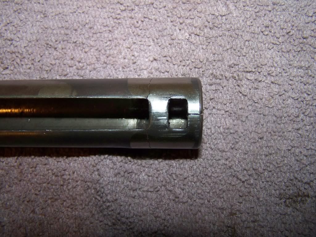

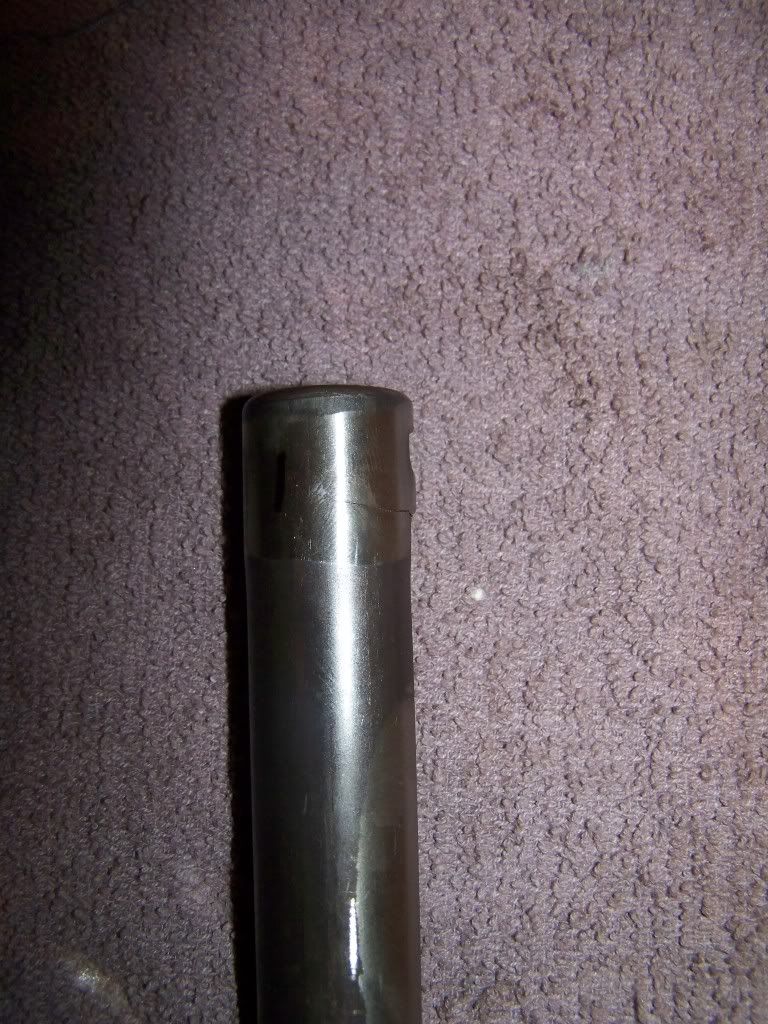

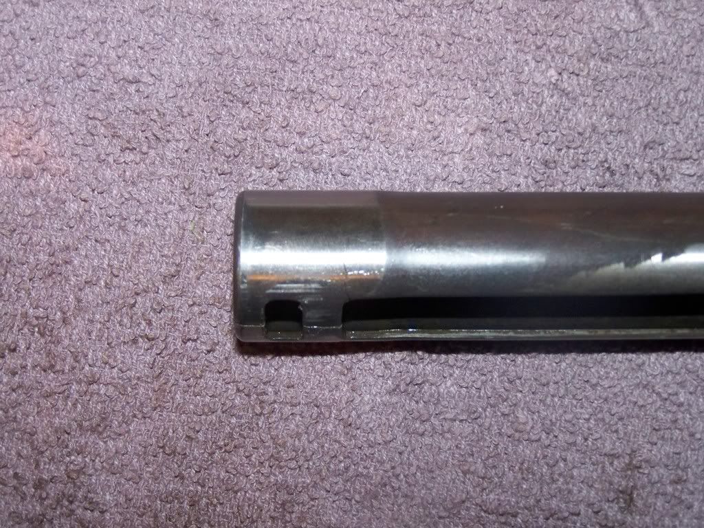

Well I called Gamo today and they Will not give me a refund since I did not buy it directly frow them. And after reading airgun depots return policy I know Its a lost cause. I decided i would take it apart to and inspect it to try to tune it.Here is what I found.
In the first pic the crack goes all the way to the black line. Also one of the spacers on the cocking arm is missing allowing it to rub on the cylinder. The spring is slightly wavy I dont know if this is normal.I think I should reassemble it and try to get a replacement. This realy sucks.

Wow. This is the first time I have seen a cracked piston. Must have had a violent event to create such a mess like that.

just a suggestion......but any decent tig welder can fix that right up............

Wow.....that is some serious defect.  Too bad Gamo and Airgun Depot don't want to refund your money or replace your gun.
I guess this is another reason to hold on to the barrel in a break-barrel rifle or cocking arm of side and/or under cockers.....imagine if the sear had hooked onto that piston....and then suddenly the piston broke apart.....it would be like the trigger was pulled.

Well, since we're in the China Gate, my opinion of Gamo's quality is expressed in two words of your eloquent choice. THEY SUCK.
They use aluminum where they ought to use steel, blind rivets and eyelets instead of threaded fasteners; poor quality of casting and machining, and then - they offer zero support, and almost no service! Most that I read, and the majority of the pictures reinforce the contra position on Gamo products. The Chinese products are in general better.
You ought to send these clear images to them. Ask for replacement, in polite but strong words. This is their chance to show they stand behind (and they better dodge fast) their product.
