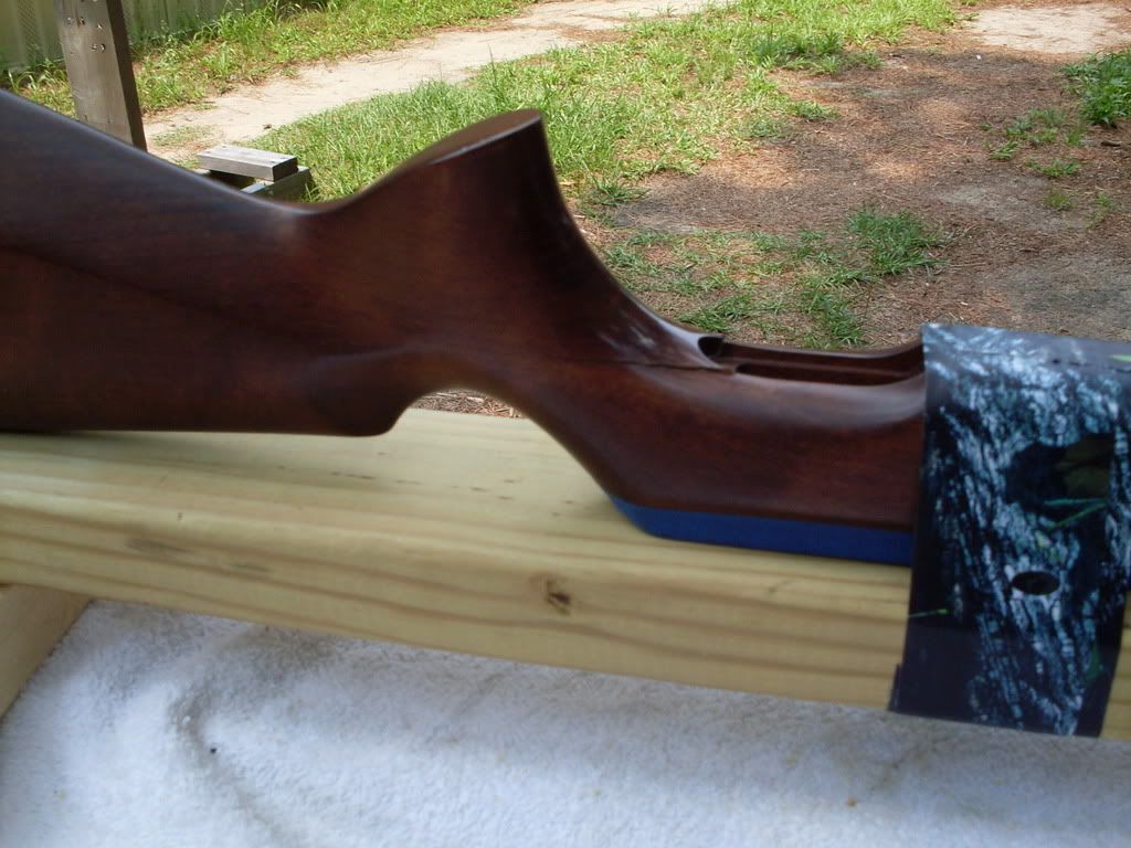

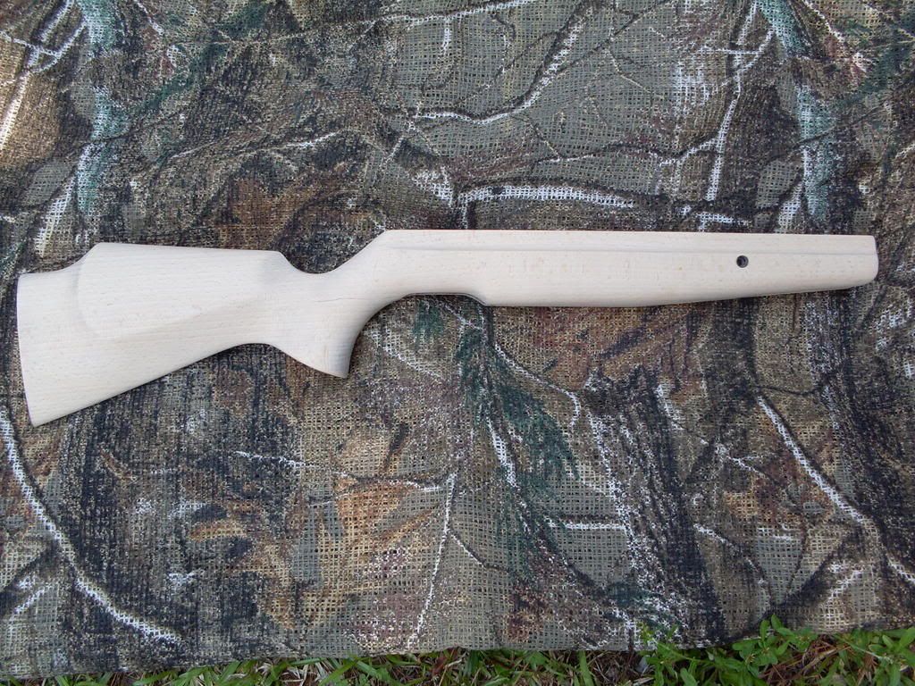

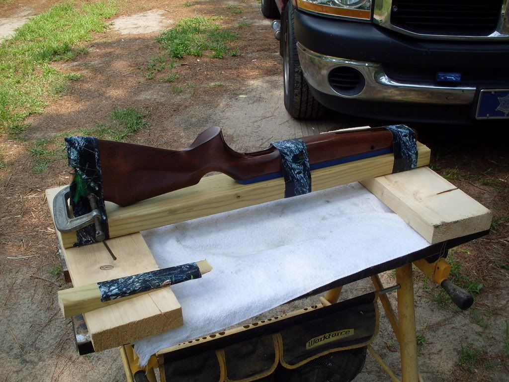

 This is a stock I am repairing for a friend of mine. Its from a Webly that cracked from an accidental barrell slam. I made a simple jig that could open the crack so I could inject marine epoxy,, & then use the wedge in the pic. to apply clamping preasure. In the pics. after I stripped & sanded it you can still see the crack,,I suspect the epoxy soffened the stain/finish & stained the crack. I was dismayed when I saw this,I should have sanded the area first,(I know better). As I had plans of using a dark stain,I hoped it would cover the still visable crack. IT DID!!! Gotta say, after just one coat of stain,even with my "super magnum reading glasses" the crack no longer is visable!! Great pains were taken sanding to preserve the crisp lines on this nice stock. (chemical strip removes clearcoat) Good old elbow grease (sanding) to remove factory stain!! The pics. dont do justice,, its looking really nice!! Ive been sanding all day,, Im gonna go shoot some now!! Tim.
