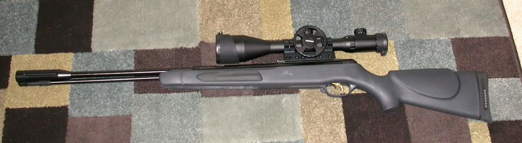

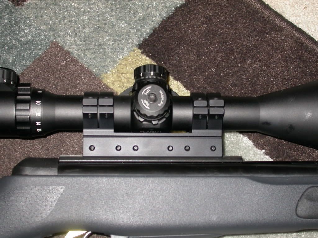

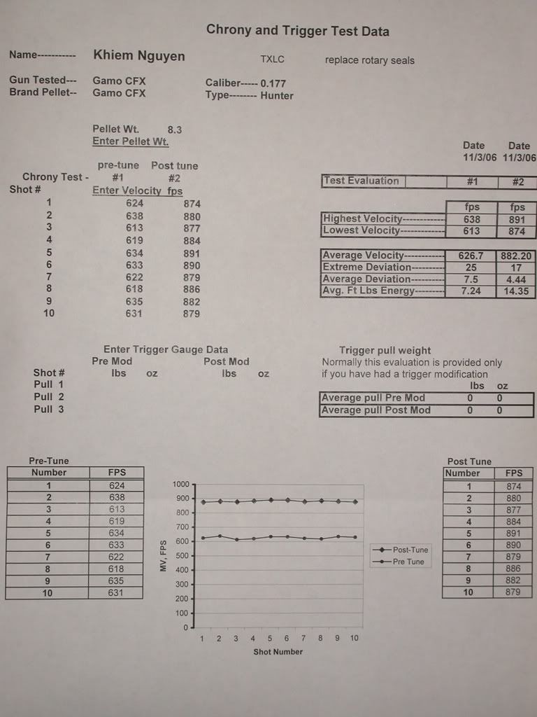

First off, I want to thank CDT for fixing my cfx's seal. It now shoots 880's with 8.3 rws superdomes. Got a chance to shoot with my BKL custome 360 mounts(4 rings instead of 2),Leapers 4-16x56 30mm Range, rich's cfx MB, and I got 1 and a half inch groups  at 45 yards. This rifle is way more accurate then I am and I know I can shoot better with practice. The scope I chose is gigantic I know but I love it none the less. Here are some photos of my rig and stuff. What kind of groups do you guys shoot with a cfx? and what distance?

Which seal was bad?
Re: Finally got my complete rig for my CFX.....
« Reply #2 on: November 14, 2006, 01:24:28 AM »
Ya me too. which seal ?
Seems like it had to be the piston seal if the power was down that far.It had to have a Big chunk out of it to go from 630's to 880's.

I dunno, Khiem, It looks like the scope is hanging over the rotating breech. That's gotta make it kind of tight getting a pellet in there !! I used a Leapers 3-12x50 Mini SWAT scope with an Accushot one piece offset mount. Keeps the scope well away from the breech. Just a thought....................Raoul

Without my scope cap, I can load my pellets fine. With it, my scope cap does make it very tight.
