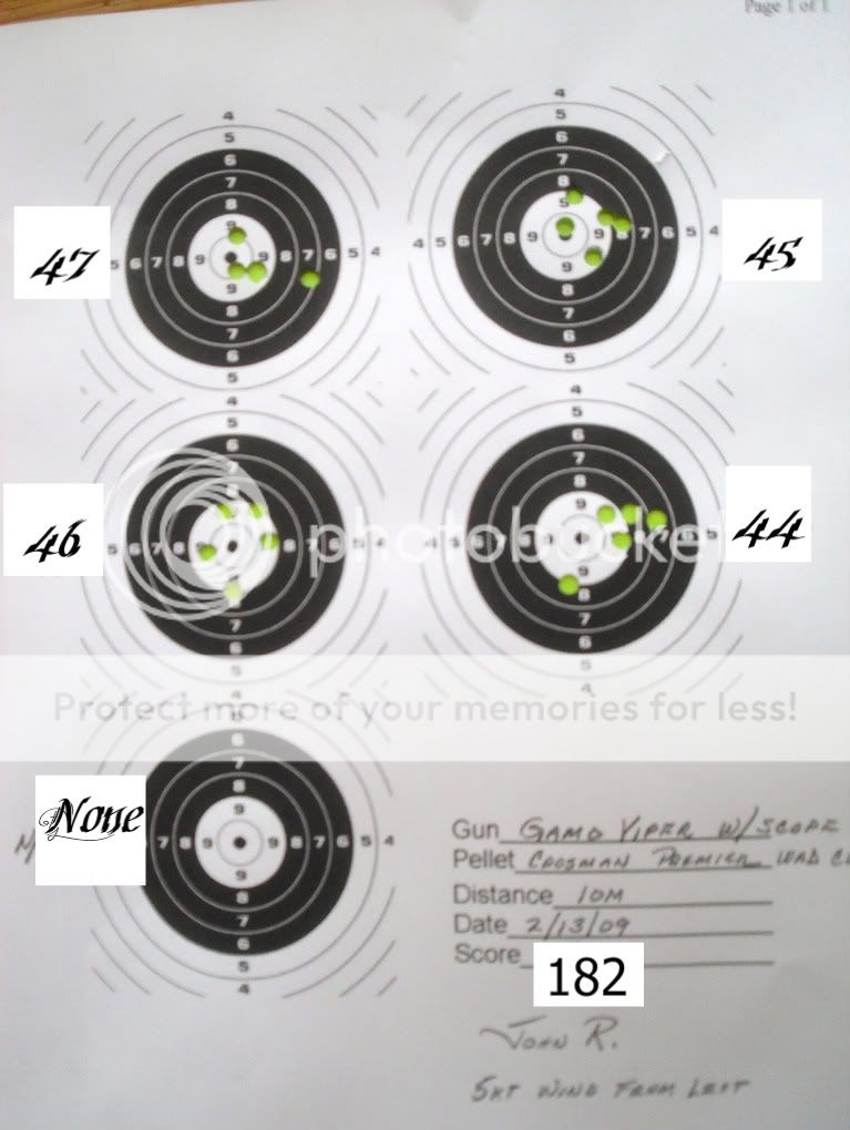

Offline Viper
  • Posts: 81
RE: Match #2--Scoring Question
« Reply #44 on: February 14, 2009, 05:11:23 AM »
Okay....dumb question here...maybe.
In scoring, when you hit a ring do you count the higher or lower number. The reason I ask, I might have added up my score on the low side.
I think government is a necessary evil, like, say, motion-picture agents.
- John Wayne
