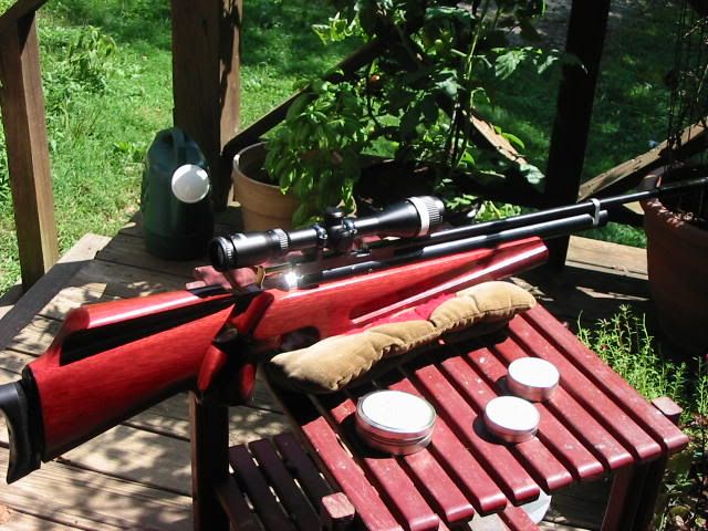

 Yes it is a Purpleheart stock :
 "Maybe the front trigger guard screw needs to be shortened a wee bit."  Did you note the nut fits one way? Dish on one side or a flat or something I cant quite recall right now but I am sure I am right about that and it "can" cause a problem.

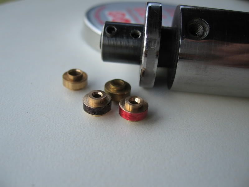

"What material did you use for your transfer port? " Brass TP's with shortened polished hammer:
 Using one of BigEd's valve stems will up the power due to better flow :
 I Ed sells them for around $10.00 ?
