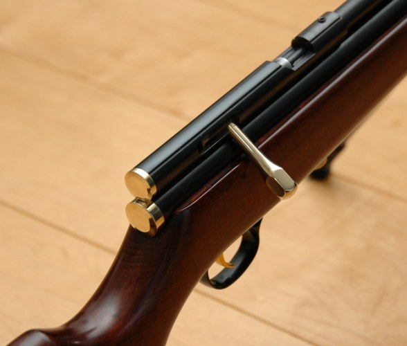

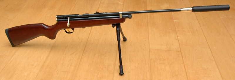

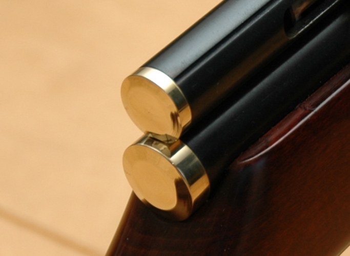

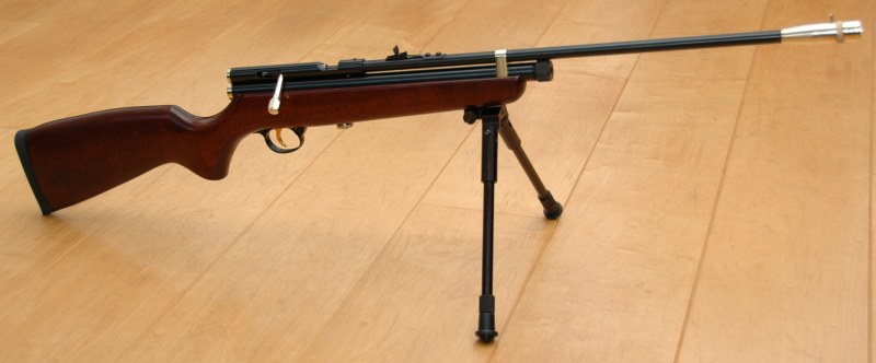

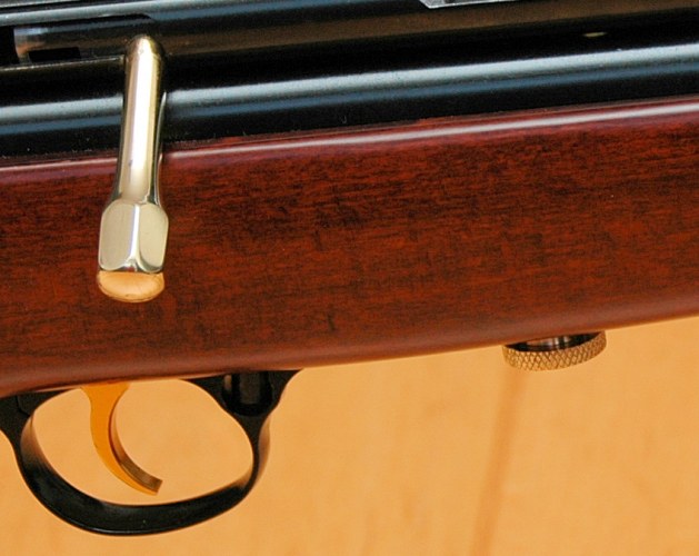

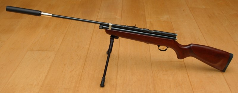

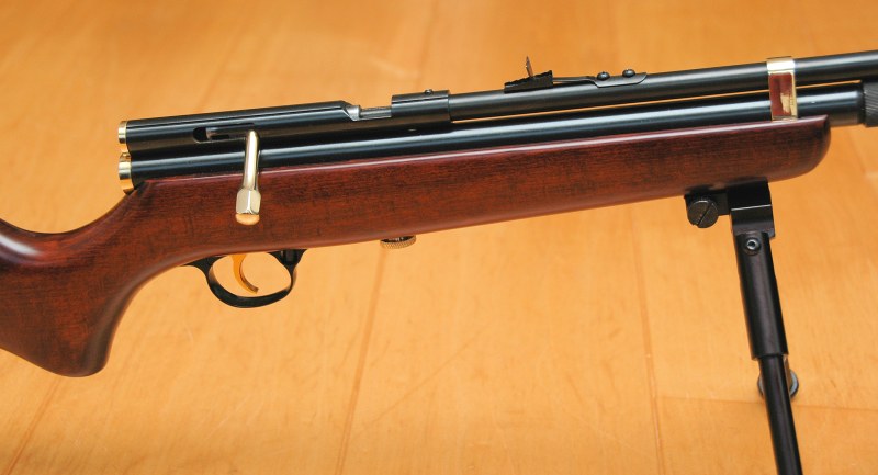

Since I'm very pleased with this rifle I ordered some brass parts from Gmac (UK)
Here's how it looks now.
MuzzleBrakes like in the pic are legal in the Netherlands.

Beautiful job on the brass metalwork. Nice tune-up.

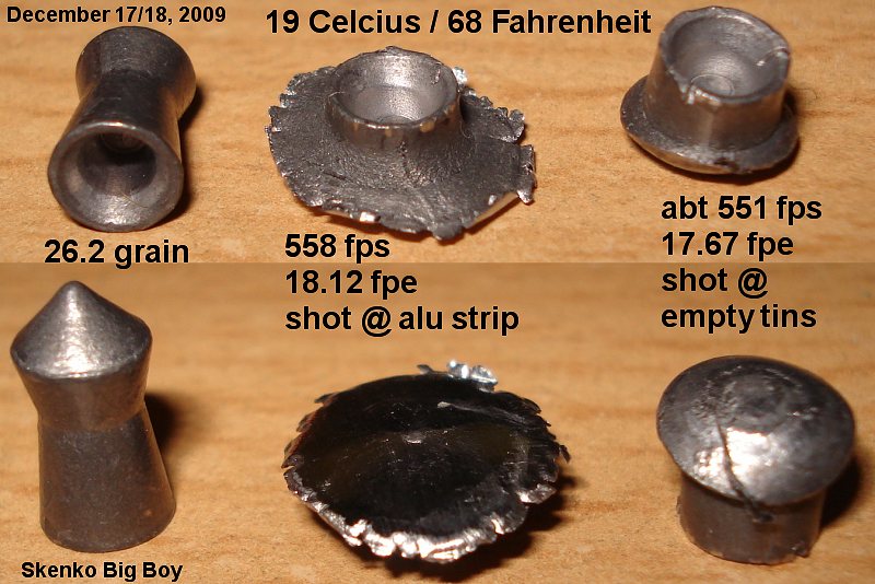

« Reply #7 on: December 18, 2009, 12:33:17 AM »
Grouping wasn't bad, 2 five shot groups @ 10 meter:

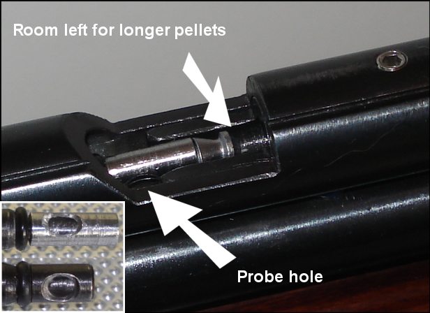

Did the extended probe mod and boy am I sorry I did.
Gain in fps: ok
Uses more CO2: can live with that
Loading pellets: big dissapointment - they tumble/tilt now
Seems to me the only way you can load a pellet is whith the barrel pointed to the floor.

« Reply #13 on: December 20, 2009, 08:12:20 AM »
Tested a few other pellets today, it seems only these H&N hollowpoints and the smaller pellets tilt, others loaded smoother.
Still think the hollow probe loads easier, so if you're looking for extra fps the extended probe is last on my list.

« Reply #14 on: January 06, 2010, 01:33:26 AM »
Thanks to a member of ukchineseairgunforum.myfreeforum.org it's got an extended hollow probe now :-)
