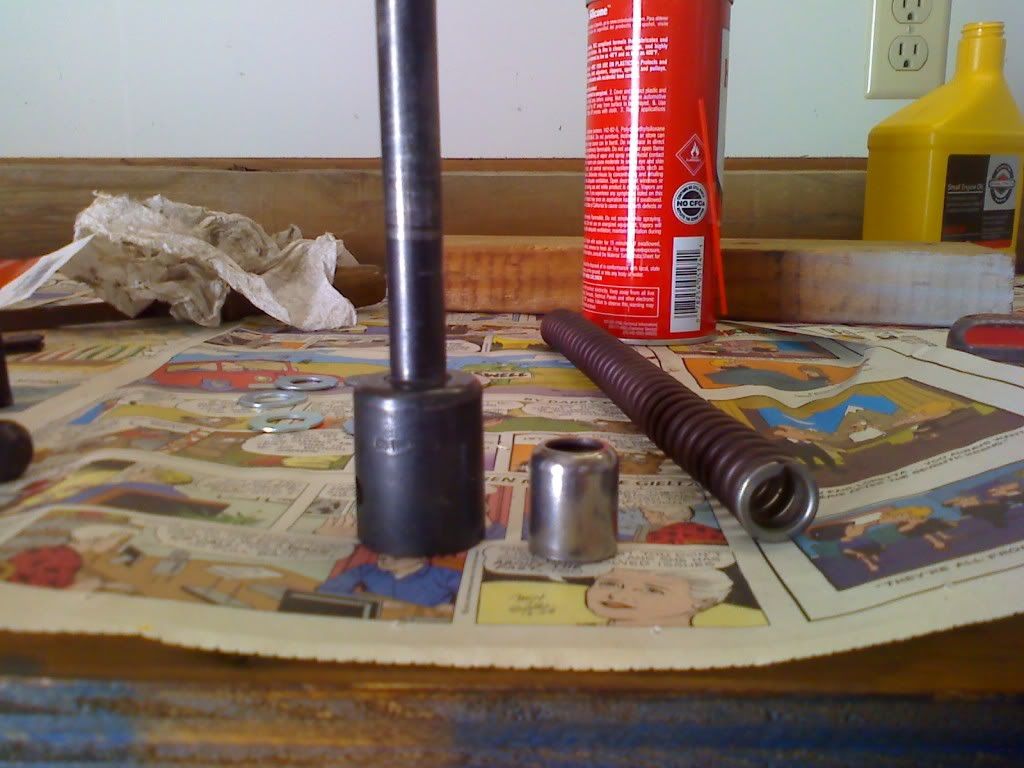

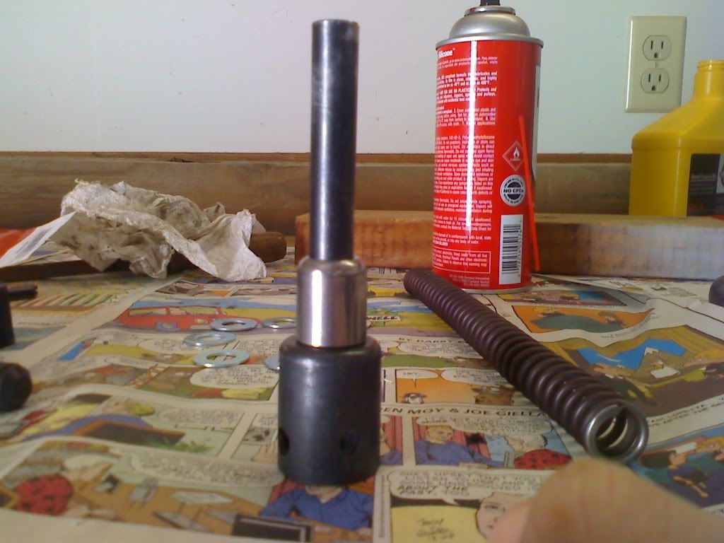

other then that the spring guide is different then the ones normaly described... its all metal with a steel spacer...took some pics will post them when I figure out how... think I seen one other old b3 on here with the same type of spring guide... IMHO its MUCH nicer then the plastic ones they seem to have now and gives probably close to an inch of extra spring room if you where to remove the spacer(slides off) to use other springs if one was so inclined...

well I said I would post a couple pics of the spring guide so here they are...
And
seems all the spring guides I have seen on here are plastic... think I like this guide better and with that spacer removable it would give about a extra inch for a different sping
