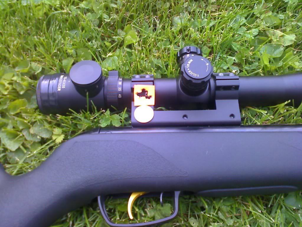

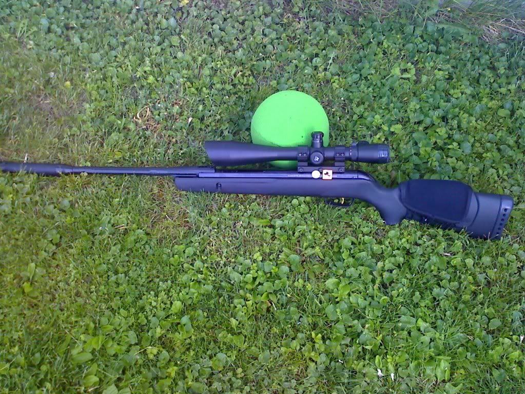

ok first two pics are of the gun after we broke it in with about 50-75 shots of CPHP's and dads first real attempt at a 10 shot group at 17.5 yards the square is 3/4x3/4 inch and thats a dime sitting next to it.....
second two pics are mine and dads shoot off cause you see... I didnt see him print that first group so of course it didnt happen right?!?! 10 shot groups 17.5 yards cphp's 1x1 inch squares(second pic of this has dads original 10 shot group too.... just so he wouldnt feel so bad )
unfortunatly for me I had not eaten at all today and drank way to much coffee and I pulled both those flyers :( dad on the other hand had a bad headache....... atleast thats our excuses :)
I am personaly super impressed by this gun now... I may not like the polymer shrouded barrel and all but with the correct tune this thing shoots.....
