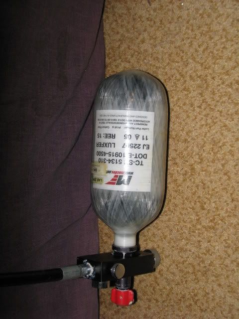

I have just completed my project "Pigmee" type CF tank for taking into the field. I had to adapt a commercial tank valve, and a friend helped out with some really skillful Lathe work. I made this up under the watchfull eye of my local Scuba tank tester, and togerther we nutted it out. It can only be filled to the pressure of the local compressors available so will be no higher than 3500 psi, but all I want is to be able to get a couple of fills in the field while on a hunt. I am relatively frugal with shot count anyways, so it shouldn't be a problem, but restricyting myself to 30 shots on a whole night hunt was very hard, as we had to let a few go that we would ordinarily have pursued.
So here it is,.....custom made in a Country where you cannot get Pigmees or Warthogs. It will feed the Exanix AR6, and get topped of from my dive tank (240 Bar) double yoke set up, as the evanix operated best at 180 Bar.

2 cool GS!Never even thought of that,now that`s a comp. leight weight setup,perfect for the bush!

GS, Thats a great setup you have there, let us know about shot counts or refill info ,after you try it out.

The CF tank will get a shakedown in the field SOONI HOPE, and I will work out how many fills from a 3000 psi top up, and a 3500 psi top up. Just so I know whether it is worth it. In my opinion, to fill the AR6 to 180 bar, mebbee two to three fills makes it worthwhile.
Fillable from the big Dive bottle also is very convenient. Am considering a part time weekend job offer at the dive shop, to get certified and fill cyliders whenowner is away on training weekends. Free air?........I reckon...lol
