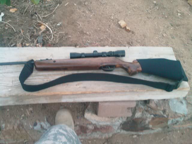

« Reply #12 on: April 28, 2008, 01:40:40 AM »
Ignore my knee, boot, and the mess around the tree :)
http://i127.photobucket.com/albums/p127/Died2Soon/IMAG0057.jpg

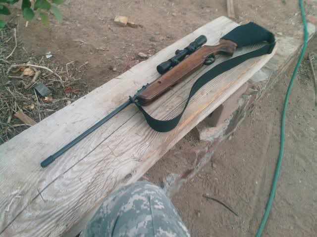

I figured I should show off the tip of the barrel. I basically just cut off the front sight, but kept the little plastic so it wouldn't look ugly. If you notice in the other pic, I modified the rear sight too.
http://i127.photobucket.com/albums/p127/Died2Soon/IMAG0058.jpg

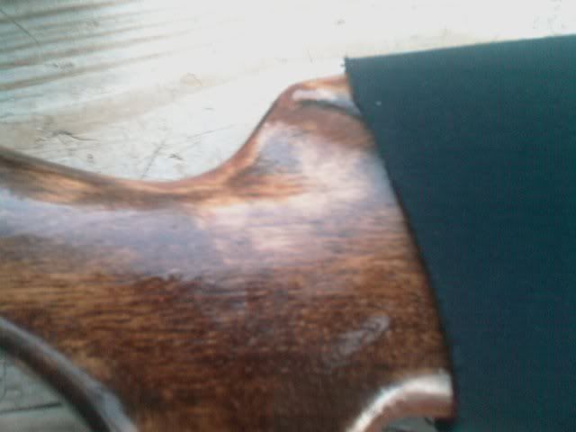

In this pic you can see the ligh/shadow effect I mentioned. The pic didn't turn out as well as I had hoped, but it stills shows what I was talking about.
http://i127.photobucket.com/albums/p127/Died2Soon/IMAG0059.jpg
RE: Pics
« Reply #13 on: April 28, 2008, 02:16:43 AM »
Turned out nice, Daniel.

RE: Pics
« Reply #14 on: April 28, 2008, 07:07:39 AM »
