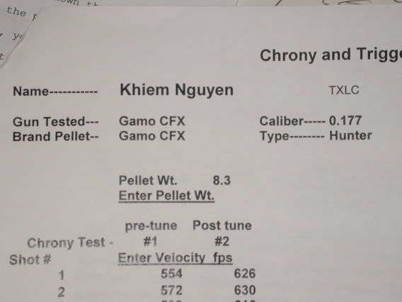

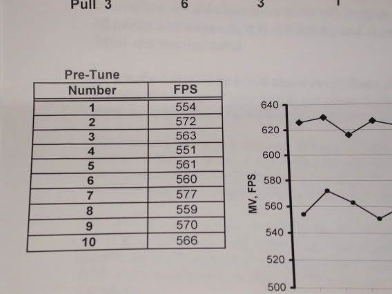

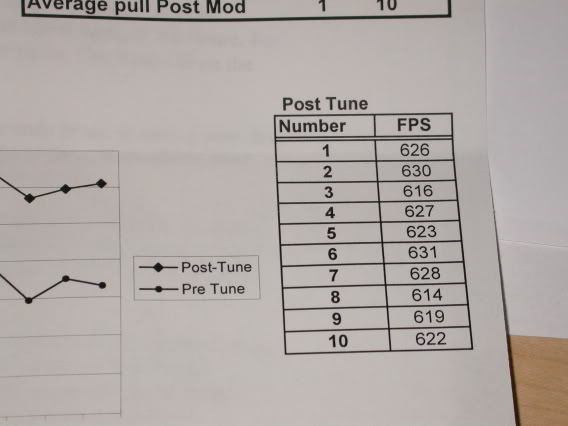

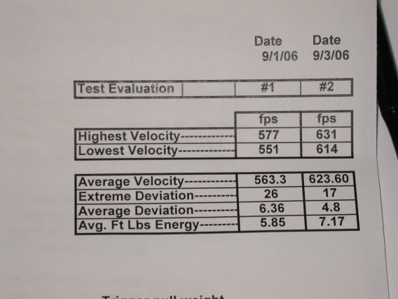

Cocking my cfx for the first time felt very smooth. I shot only a few after work since it was dark out. This cfx will probably get shot over the weekend, hopefully on some squirrels. As for the Chrony and Trigger Test Data:
Turbo Tuned.
Gun Tested : Gamo CFX .177
Brand Pellet: Gamo hunter 8.3 gr
Trigger pull weight: average pull Post Mod 1 lbs 10 oz
My CFX I sent out to CDT is pretty much brand new. The only mod was the GTX trigger install. One prob it did have was that fact that the factory seal was loose, prob because it was a display model and the public opened the breech w/o cocking the rifle afew times. I sent it out to CDT, he worked his magic on it but something puzzled me. Not owning a chrony, I never new what my velocity was. I assumed it was around 1000fps +/- 200fps depending on the pellet grain. But after I got my CDT print out, well.... it was extremely low. CDT did his magic and I am extremely satisfied with his work. My fps read:
Highest velocity : Pre-tune = 577, Post tune = 631
Lowest velocity : Pre-tune = 551, Post tune = 614
I have read and understood that my velocity may be a little low but as the seal breaks in and mates to the compression chamer it will increase, usually somewhere between 3-5%. That means when it is broken in, I would add like 30fps or less to my post tune number. Are all CFX' chronied this low? I was expecting to see atleast 800fps from my cfx. Here are some photos of my print out from CDT.

Compare our CFX' both with turbo tunes, both using the same pellet, I dont understand why there is a great defecit between our cfx'.? Can anyone help explain please? :0
RE: Just got my CFX from CDT today.
« Reply #5 on: September 07, 2006, 02:49:23 PM »
Kiem, there is a difference in pellet wt between your tests and mine. That would make yours a bit slower in fps. If you look at my two CFX results you will notice that one has slower fps than the other. What I go by is the deviation. The lower the deviation the tighter the groups are when shooting or hunting. Consistancy is the key to a good springer when it comes down to daily shooting.
I can't explain why your CFX has slower fps than mine. It could be your CFX is an oldermodel. I am aware of internal design changes. That may be the reason. Gamo advertises 1000 fps but generally you can knock off 20 to 30 percent because they use the lightest pellets on earth to test them.
