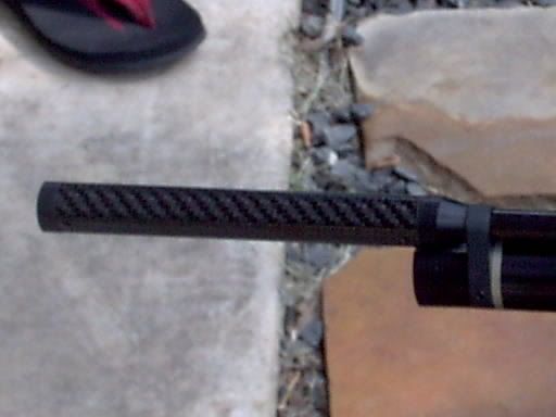

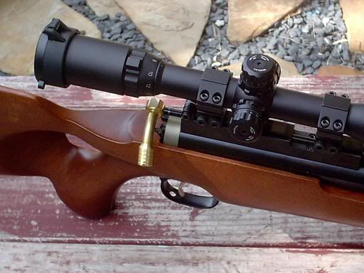

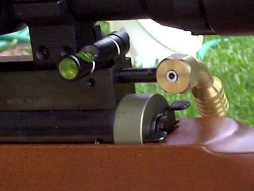

Had a little extra time in the shop yesterday so I thought I'd try getting to know the lathe a little better.  Been wanting to replace the cocking handle on my B51 since I first saw it, so I thought that yesterday with some free time would be a good of a time as any.  I spun up the bolt handle yesterday, then took it home to get it all fitted up.  Today I went after it with a blowtorch to put the correct curve into it.  Brass is pretty forgiving as long as you anneal it with a torch during the bending process, otherwise it work hardens and breaks.  I also went after the factory "hook" a.k.a. trigger a little more and reshaped and polished till it felt more like a trigger.  This is a Big Ed tuned B51 and it is one great shooter.  Added the Mountain Air carbon fiber shroud a couple months back.  Anyways, here's the pics:
She's almost complete!

Nope there is no power adjustment on a B51.  There are however a few ways to internally control power.  Mine was tuned by Big Ed Stack.  Part of his tune was to install a lighter weight hammer spring.  The shot count compared with fill pressure on this gun is AMAZING.  I get about 30 good shots right around 17.5 FPE on a 1700 psi fill.  After the 30 shots it's only down 500 psi at 1200psi, so 30-40 pump strokes and she's full again...much easier to pump than my Career or my Talon.  It spits out 10.5 grain Crosman Heavies right between 850-875fps, and standard weight pellets like CPL's up around 950.  It's not a super powerhouse like my Career, but for just plain accurate target shooting it's hard to beat.
The standard B51 cocking lever is more like a pull plug like you described, the one on there now I made at work on the lathe.  I've always been a sheet metal guy, but not much of a machinist.  Now that I run a shop with these huge machines I am starting to learn how to use them a little.  I spun that cocking arm up in about 15 minutes.  It took me longer to bend it and fit it to the gun:)  Which I had the machines I have at work here in my garage, I can only imagine what fun I'd have.
