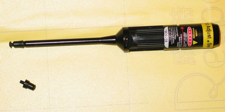

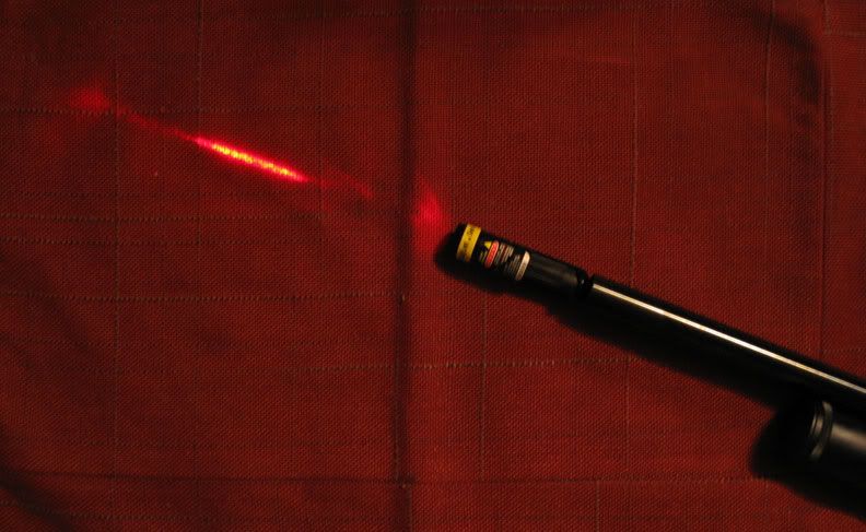

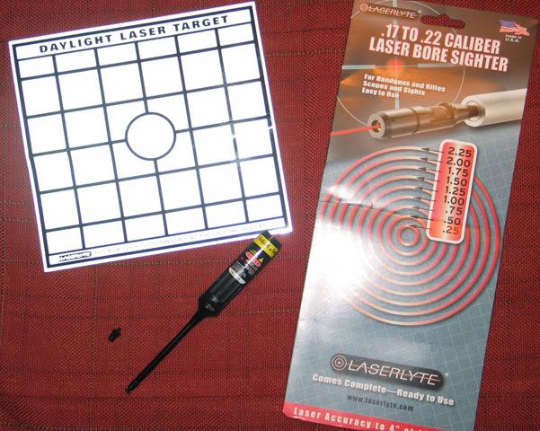

The LaserLyte revealed...
« Reply #10 on: June 19, 2006, 04:45:24 PM »
OK, as requested, photos of a real live LaserLyte scope sighting-in tool in action.
One picture shows the LaserLyte which includes bushings for various calibers, the .177 is attached to the end of the shaft, the one for .20 and .22 are the same and shown next to the laser.
Next picture shows the laser with the daylight reflecting target, nylon case, and packaging and directions.
Lastly, picture shows the light inserted into barrel of my AA410ERB with the light turned on.   8)
The only negative to the LaserLyte is that the shaft is only about 3.5 inches long, so if your barrel is deep inside a shroud or muzzelbrake, it may not reach the opening of the barrel.
Usual warnings apply - don't stare into the light, and don't point it at commercial aircraft unless you want a long forced vacation at govt. expense.
Point the gun at your target (paper usually works fine - reflector just needed in bright daylight) and adjust in real time while looking downrange through the scope.  Takes only a few seconds to be very close to being sighted-in.
REMOVE the LaserLyte (do I really have to remind people of this?), and fine tune your scope/open sights/red dot with a few pellets like you normally do.
