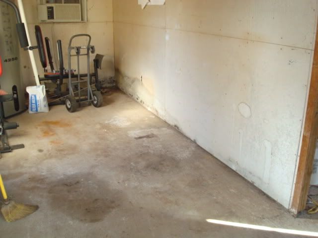

OK. Step one complete! Site acquisition and prep. Little breaux got over me heckling him and offered up a good idea for a sturdy bench. Gonna be 8x3 and the left over will make a 8x1 shelf above it.
This is a really good spot cause I can close it off and it has a window air conditioner installed in the back window. Beer fridge is not in the picture but all I got to do is turn around and grab one.
Even comes with a cool work out center I can hang stuff on!!!!!

Breaux  that looks like a good spot..  cool in the summer and fridge in the room...  Nice place to play with yur toys..

3' is too deep to comfortably reach the back of.  There is a reason countertops are 2'.   If you can access both sides, then 3' is ok.   Something a little taller than the regular 36" for tinkering.  Some task lighting will make you happy also.  Shelves are your best friend.   A muffin tin makes a nice place to put small parts.
