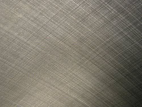

What exactly is cross hatch?

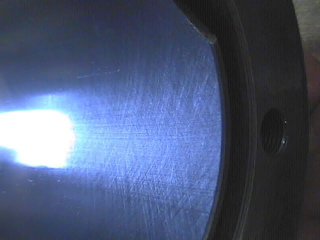

Offline speedturtle
  • Posts: 376
Re: Chamber honing tools
« Reply #12 on: October 04, 2009, 01:39:22 PM »
This image was taken from this link: http://www.jockeyjournal.com/forum/showthread.php?t=36280
A Sunnen AN hone tool was used to properly set the I.D. of the cylinder to make it really concentric on the bore. A flex honing tool was used on the latter stage to produce this cross hatch pattern.
Here is another fine example of a cross hatch pattern:
This image was taken from this link: http://www.productionmachining.com/articles/when-the-bore-needs-more.aspx
Hope this helps.

Offline chortdraw
  • Posts: 309
« Reply #13 on: October 04, 2009, 02:18:55 PM »
Very much so...thanks speedturtle
