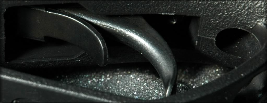

I just got a Whisper VH this week from Amazon. Since we are deep in snow here in Syracuse I only had a chance to take one shot out the back. I noticed the trigger took quite a bit of pull. So of course I got online and started to read about triggers when I came upon Tuna's warning about the plastic triggers. My heart sunk. I ran right over to my new gun with a magnet and sure enough it stuck to both the trigger and the safety lever. So I'm assuming I got the older version? Is it correct to apply the magnet directly to the visible portion of the trigger where your finger goes or do you need to check inside the stock somewhere? I'm hoping there is a trigger mod in my near future... Thanks.
Mouseover the image below for a close-up of the trigger.

Congrats on the new Whisper.  You checked the trigger correctly and sounds like you did in fact get one of the "older" ones,,,,which is a good thing.   Do yourself a favor and order one of Bobs triggers,,,, you simply will not believe the difference it will make.  It's extremely easy to install and will increase you accuracy by leaps and bounds as well as increase your enjoyment of the rifle.

Nice close-up ! Yes, that looks exactly like the  stamped steel trigger on my 22 Whisper. Swapping in a "Tuna trigger" is a must if you want to get the most out of the gun. And you'll be glad you did.

Jim, The reason they include the PBA pellets is because they suck,....and they can't sell them,...except to newbies that get hooked on the BS idea that high velocity is the way to go.  NOT!!!!!! The next best thing you can do aside from installing the GRT-III blade is to toss the PBA's in the trash can. Try the Crosmans for a while to get the action broken in, and cycle out the residual factory lubes  for now. Clean the barrel after a few tins and then order some 'good' pellets. I see no reason to immediately clean the barrel at this stage because it will only  'dirty up' again in short order because of the lubes. Shoot the heck out of it and don't worry about pin-point accuracy until everything settles in. Jeff gave you a very good piece of advice on cleanning the barrel, but I'd still hold off until the initial break-in is performed. After that, clean it, and shot it alot to really season( light-leading) the barrel. I guarentee over time your rifle will come into its own. Just be patient and shoot often, tjk

Hey Jim, GREAT choice of AG and thank God you got the steel trigger!!!! Get in touch with the tuna ASAP, and drop in the GRT trigger. Literally, night and day!! I have 3 different model Whispers, all .177. All have a ton of pellets through them. All have GRT's and have been Turbo Tuned. I know I might be a little biased, but these guns are a joy to shoot, very accurate and look awesome!!! The problems I have encountered were the scopes Gamo supplied and those ridiculous pellets. Hang on to the scope till it falls apart, which won't be that long, and DO NOT use those pellets!!!!! I get my best groups with Crossman Premier Lights, JBS Exacts and Gamo Tomahawks. The guns hate any pellet that weighs under 7.5 or over 9 grains. Anything else we can help you with, don't hesitate to ask!! Enjoy that bad boy, you're gonna love it!!!! I'm sure we'll be hearing about your next purchase soon!!!!! Let us know how she works out for you bro!!!!

Not sure if I mentioned it in this post, but I did get the golden trigger and it makes all the difference.
