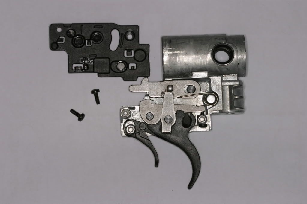

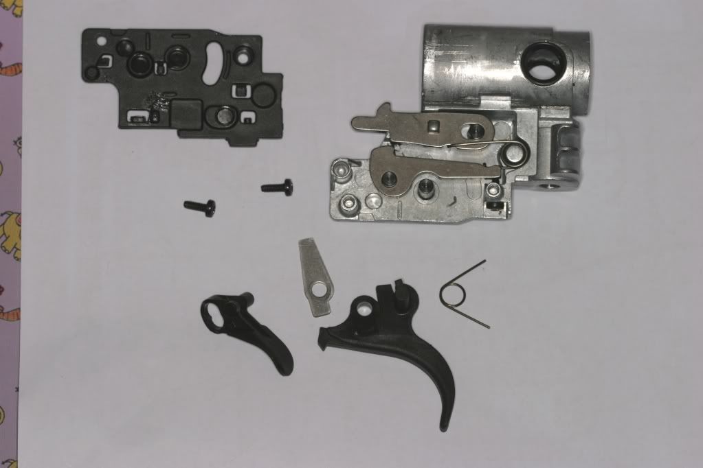

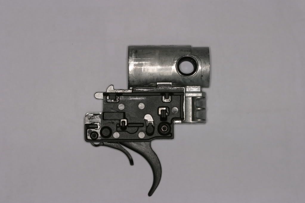

It doesn't seemed that bad after taking it apart. At least the 3  pins doesn't need to be removed to remove the trigger and sear. So if somebady want to make a aftermarket trigger.....it is not impossible I think. Although not as easily drop in as the old metal trigger group.
The plastic plate was held in place with 2 T-8 screws.
Joe

Great pics, thanks for posting them and also welcome to GTA.... very nice to have you with us  :)
I'll be looking forward to your future posts.

thanks for posting the photos.  I have been wondering what the new trigger assemblies looked like.

Yep it looks like the same mouse trap Gamo is putting on all the new guns except the Extreme which would eat that up in 10 shots..:)
Re: CFX plastic trigger
« Reply #4 on: March 11, 2010, 02:38:44 PM »
Still think Gamo went the wrong direction with the newer design. :0 They already had a simple design that could be transformed into a great trigger with the GRT-III drop in. :) Ed

I was quite worry when I got this....but after shooting it awhile and adjusting the only adjustment screw that it has it doesn't feel bad at all. The break of the sear is quite crisp and very preditable although it is just a one stage trigger. I open the trigger intended to polish the strut and sear to make the action better but it turns out that they are with nice smoothness and the tapered metal plate done a nice job keeping the action all in  one plane(much better than the metal trigger CFX that I have)
After a few assembly and disassembly, I come to appreciate the tail block/trigger group....it really make the process much easier. Once the front of the assembly catch the right place, the rest of it just glide in. And the whole action drop in the stock nice and accurate...without any small parts to worry about.
